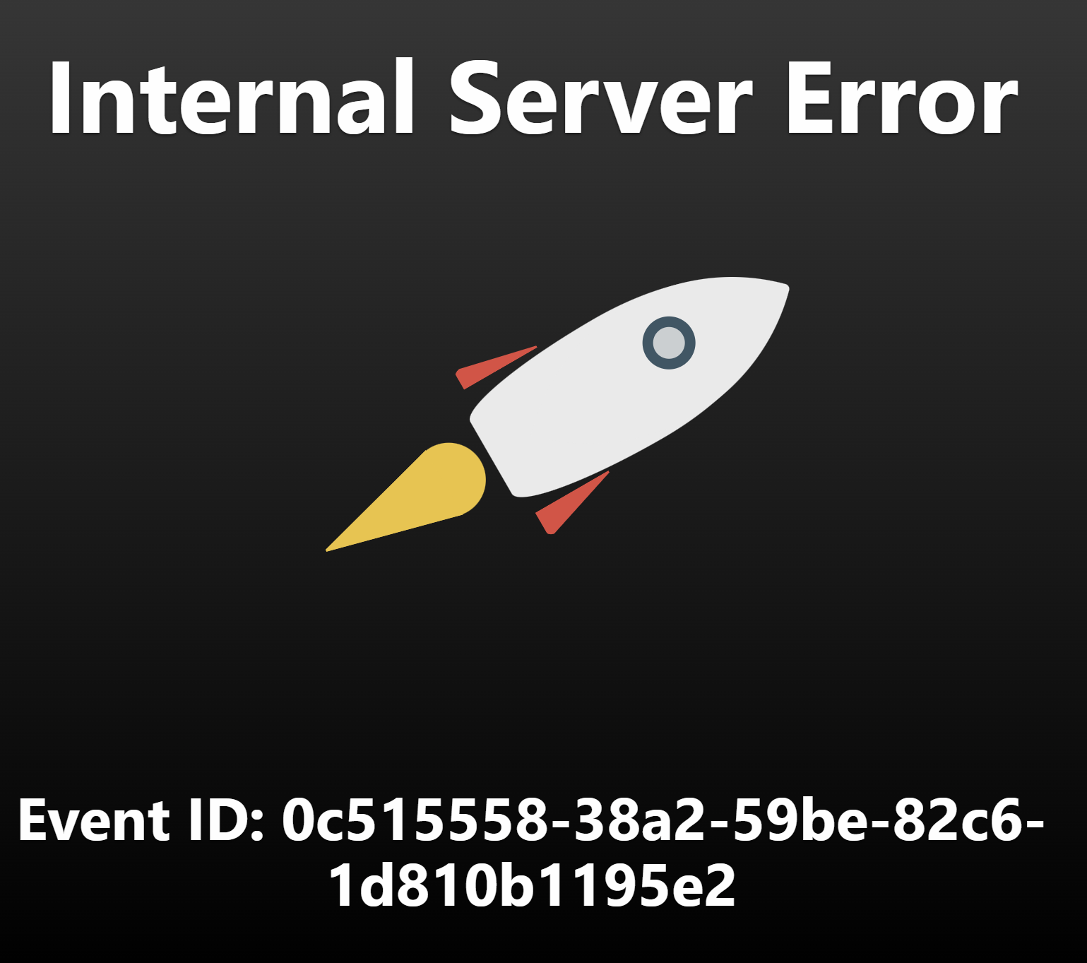

Any unhandled exceptions will be converted from a placeholder page to the actual stack trace. Appending ?FULL_STACK to the page request dumps the entire stack, which may be several thousand lines. By default, full stack dumps are disabled in lieu of abbreviated stringified traces.
